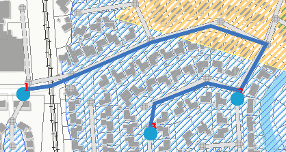

Hi Developers,
  I want to have a Circle marker followed by a value geometry location. Right now I am using the below code. But its giving me either of the functionality. Not both at the same time.
var CircleSymbol = new SimpleMarkerSymbol(SimpleMarkerSymbol.STYLE_CICRLE, 10,
new SimpleLineSymbol(SimpleLineSymbol.STYLE_SOLID, new Color([255, 0, 0]), 2),
 new Color([0, 255, 0, 0.25]));
textSymbol = new TextSymbol(stop.attributes.OBJECTID);
textSymbol.setFont(font);
textSymbol.setColor(new Color([255, 255, 255]));
stop.setSymbol(CircleSymbol);
stop.setSymbol(textSymbol);
While I am looking for a style like below.
In case you have any suggestion or solution please share.
Thanks in advance.
Kumar

Hi Robert,
This the routing result i am getting. Once I grad the 2 stops out of the map extent and bring them back, you can see the text symbol changes its position.
i am using the route task here,

Any suggestion why its performing in this way.Please share.

Aditya,
  Same thing I said before. Right now you are adding the circles then setting the stops symbol as the text. Instead add the circle as the stop symbol and then add the text after.
