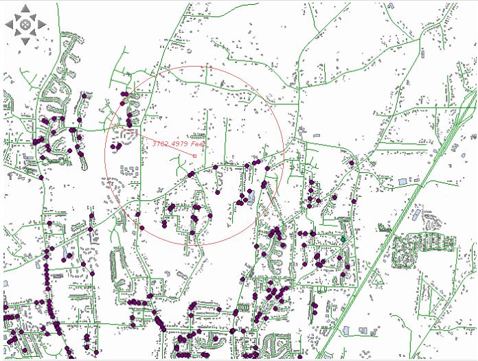

Showing radius line and measurement while drawing a circle on map
5241
02-26-2016 10:53 AM
RichardMoussopo
is anybody ever done this?

Richard,
Here is a sample that draws the circle with a radius line and the measurement.  It uses geometryEngine to calculate the size of the radius.  If you are using a projected map, you would want to use a planarLength instead of a geodesicLength.

I have a working sample at:  http://gis.yakimawa.gov/demo/circle.html
It is a bit unusual.  Clicking and dragging the map pans the map.  This example also draws a circle.  You can also right mouse click and not pan, but you will see a context menu when you finish the circle.

RichardMoussopo
Thank you Tom, this is a real good start.
I created a repository on Github with a demo sample. There is an issue though when switching the measurement units other than meters.
you can try view the demo here
https://github.com/rhyck-m/Drawing-circle-with-radius-measurement-display

Richard,
You are welcome. To calculate the radius you need the measured units in the same type as the base map you are using. If you want a the radius displayed in a different measure unit, you can convert the value or do a second geometryEngine.geodesicLength call.
