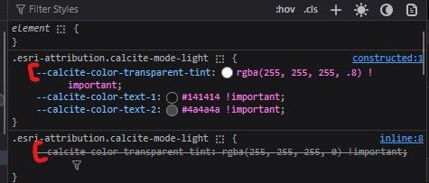

LMFGeospatial
@Sage_Wall I'd like the ability to apply CSS to the Esri attribution. Look, I understand the aim to limit alteration of Esri's Calcite design. And I understand the reticence of allowing users to remove attribution completely (the Powered by Esri included). I am not looking to remove it. In fact, I never have. But I have worked to at least minimize the impact of the attribution's background color and transparency. Most of our applications are built with requests for customization - especially colors. But here you have this semi-transparent #fff background for the attribution that we can no longer affect with external CSS, as it's hidden down in the Shadow DOM now. Again, I don't want the ability to remove it. But yes, I'd absolutely like to change the color or opacity - in the past, I have removed the background altogether, retaining only the text. It's less intrusive and does not conflict with custom color designs.

LMFGeospatial
@Sage_Wall I have tried to to append child styles already but have had no luck. Even using your code, the "constructed" styling supersedes my inline styling:
The esri attribution is, if I understand it correctly, styled in the shadow DOM of the arcgis-map component. So that's how I've attempted to address it. But the style still does not change - the constructed style is retained.

LMFGeospatial
I appreciate this. This does indeed demonstrate an ability to reach the attribution styling. It certainly minimizes the impact by significantly cutting down the width and, via opacity, muting the color a bit. I would still prefer not having to change width. And opacity affects not just the background but the font text as well. As I've noted, I don't want to remove it altogether. My preference would be to have the font at 100% opacity and the background 100% transparent.
MatthewDriscoll
MVP Alum
You don't have to change the width, I was just giving an example.  Here is the js to get rid of the background.
Take note that I am using dark mode in my design, so you will probably need to change that if you are not.
await mapElement.componentOnReady();
const shadowRootAttr = mapElement.shadowRoot;
// Use an adopted stylesheet to beat the constructed stylesheet
const sheet = new CSSStyleSheet();
sheet.replaceSync(`
  .esri-attribution.calcite-mode-dark {
    --calcite-color-transparent-tint: transparent !important;
  .esri-attribution {
    width: auto !important;
    max-width: 50% !important;
    border-radius: 8px 8px 0 0 !important;
    right: 0 !important;
    left: auto !important;
// Adopt it into the shadow root — appended last so it wins
shadowRootAttr.adoptedStyleSheets = [
  ...shadowRootAttr.adoptedStyleSheets,
  sheet
