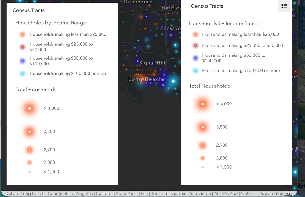

Untitled.pngIs there perhaps some custom CSS styling producing the padded attribution.  By default there shouldn't be any space between the bottom of the attribution and the bottom of the map or scene component.  It should still be at the very bottom of the view, unless I'm misunderstanding the issue I don't know where the padding or margin is coming from in your screenshot @MatthewDriscoll

That is strange.  The reason I know how to change the attribution is because I ran into this.  All I did for the screen shot was comment out the attribute code fix.  But today it is not doing it.  But, yes it is possible I did something I guess.
