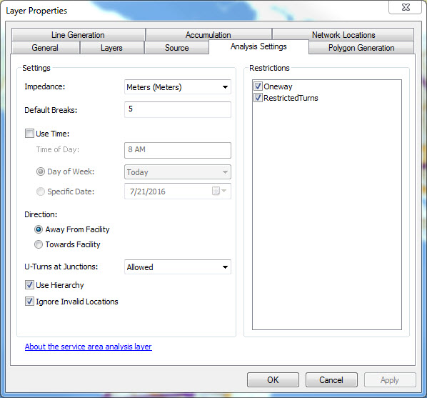

hi Russell,
I think you will need to publish your own NA service which could calculate service area based on impedance value as travel distance instead of travel time, for example, the service used in our sample:Service Area - Network/USA ,
you will see there is an Impedance parameter which has value of "minutes", And to adjust it ,for example to "Meters", you can do that from the ArcMap from your layer properties, see the attached screenshot below:
However, you can use buffer task of JS api to create a buffer zone based on the drive distance.
DriveBuffer | API Reference | ArcGIS API for JavaScript 3.17
CreateBuffers | API Reference | ArcGIS API for JavaScript 3.17
