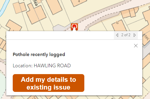

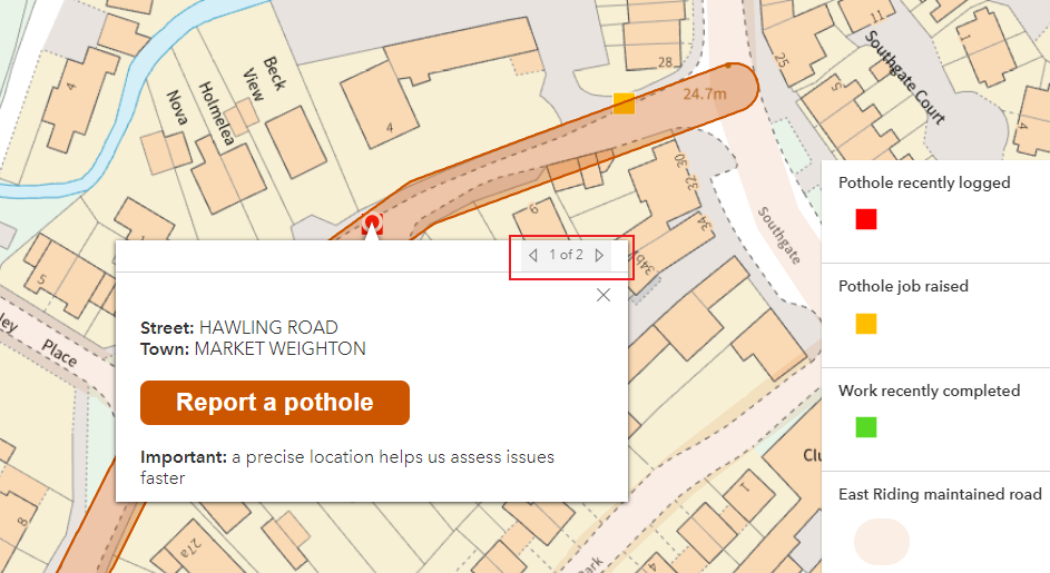

My query/issue is, is that when I try to click on a point, it always selects the line layer first (despite graphically it being on top). I then have to cycle through the popup results for it to select the point and display its popup.
As you can see in the image below, it's selected my line layer despite me clicking on the point.
It displays the line layer popup firstIt displays the line layer popup first
I then have to cycle the popup for it to select and show the point
