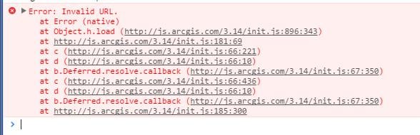

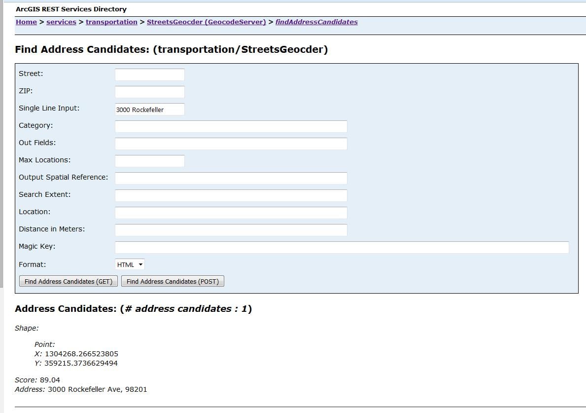

Trying to use the Search widget for the first time and I'm getting an "Invalid URL" as I start to type in the widget. The service itself works since I can use it via the REST directory:
I'm modeling my code partly after what's in this thread (April 22nd by John Ritsko). Anyways here's my code:
    var s = new Search({

Here's the error in the console:
I've tried both an absolute URL to the Geocoder service as well as the relative pathing as shown above. So what gives?

ChrisSmith7
Honored Contributor
Have you tried debugging your code to see the resulting URL on the request? It may be incorrect... I would also have a look at capturing the web traffic using Fiddler - this could shine some light on the issue.

SteveCole
Honored Contributor
Thanks, Chris. Your response led me in the right direction. I was fixated on the front part of the URL and didn't notice that the actual operation it was requesting ("suggest") did not exist. When I switched the "enableSuggestions" option to false in the constructor, the widget worked as it should.
I need to re-create the geocoder in 10.3 to get it to work with suggestions. Thanks, though!
