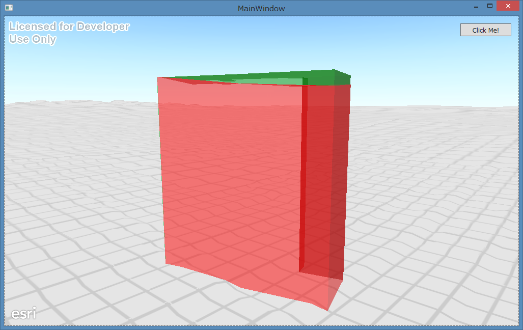

FYI, in ArcGIS Runtime SDK for .NET version 10.2.6, it can be by the Maximum mode of ExtrusionMode Enumeration.
Red: BaseHeight mode
Green: Maximum mode
