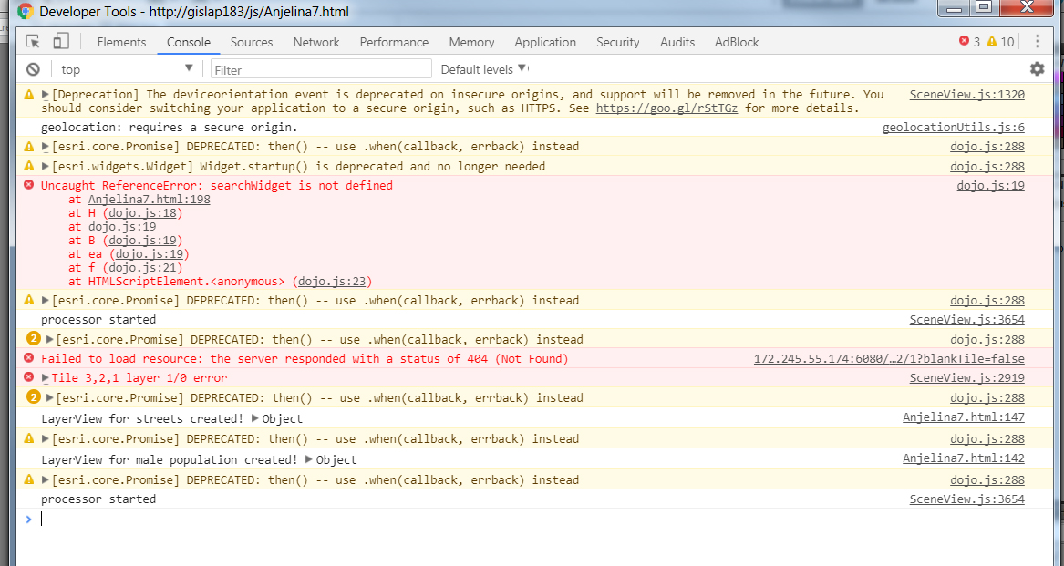

RobertScheitlin__GISP
MVP Emeritus
Anjelina,
  I get a couple of errors using your code. You need to use F12 browser developer tools and forget about FireBug (firebug is basically obsolete now that modern browser have such good developer tools).
You have:
view.ui.add(searchWidget, {
  position: "top-right"
When your search widget var is called search not searchWidget.
Your next issue is that you are setting the position in your css rule for #search yet you are trying to have the API set it's position using view.ui.add and position top-right.
anjelinaponkerat
Thanks
but I have problem after apply your suggestions too. this is my changes:
MVP Emeritus
Anjelina,
  Well you switch from one issue to another... Your first code snippet has
var searchWidget = new Search({
  sources: [{
    featureLayer: new FeatureLayer("http://localhost:6080/arcgis/rest/services/city_denver/FeatureServer/0", {
      outFields: ["*"],
// For some reason you still have the above trailing comma and proceeding properties
//even though I mentioned this before.
    outFields: ["name","town"],
    displayField: "name",
    searchFields: ["name"],
    placeholder: "example: denver",
    exactMatch: false,
    zoomScale:10000,
    maxResults:6,
    maxSuggestions:6,
    autoNavigate: true,
    enableSuggestions: true
  view: view
}, "searchWidget");‍‍‍‍‍‍‍‍‍‍‍‍‍‍‍‍‍‍‍‍‍‍‍‍‍‍‍‍‍‍‍‍‍‍‍‍‍‍‍‍‍‍
Then you have:
  position: "top-left"
Which is great.
Then you have:
<body>
  <div id="viewDiv"></div>
  <span id="layerToggle">
    <input type="checkbox" id="streetsLyr"> new base map
  </span>
</body>
So this issue is that in the first code block line 21 you are creating the search widget and placing it at a div called "searchWidget" which does not exist.
  1. So you need a div called "searchWidget".
  2. If you are going to use view.ui.add then you DO NOT want a css rule that positions the "searchWidget" div.
