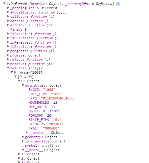

LauraMiles1
I'm not sure - console.log(queryDeferred) will successfully log the array to the console so they are existing inside queryDeferred...
This is what I see in the console:
SteveCole
Honored Contributor
Ok, based on your newest screenshot, the query results are in the first element of the returned results, so..
var theResults = queryDeferred[0]
LauraMiles1
Thanks Steve - so, should I be able to get information as I would in a one dimensional array? Printing queryDeferred[0].length to the console results in a "TypeError: Cannot read property 'length' of undefined"
SteveCole
Honored Contributor
Doh!. actually, it might be this instead:
var theResults = queryDeferred.results[0]
This is where it helps to add breakpoints so you can interactively work with variables.
LauraMiles1
Hey Steve, I still get the same typeError trying that way. I've made a new "discussion" here because this is kind of a separate question from my original one that Robert had answered. Reorder Query Results - Multidimensional Array?
