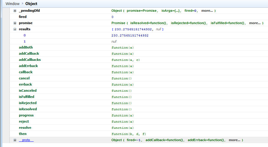

This is killing me. Been working on this for hours and can't seem to work this out.
Here is my function.
function selectInBuffer(results){
        //console.log(results);
        sResults = {displayFieldName: null, features:[]};
        var feat;
        var features = results.features;
        for (var i = 0; i < features.length; i++) {
          var feat = features;
          tfeat = feat;
          var distParams = new DistanceParameters();
          distParams.distanceUnit = geometryService.UNIT_FOOT;
          distParams.geometry1 = pt;
          distParams.geometry2 = feat.geometry;
          distParams.geodesic = true;
          distp = geometryService.distance(distParams);
          console.dir(distp);
          tfeat.dist = distp;
          feat.setSymbol(symbol2);
          feat.setInfoTemplate(infoTemplate);
          map.graphics.add(feat);
          if (!sResults.displayFieldName){ sResults.displayFieldName = results.displayFieldName }
                sResults.features.push(feat);
        console.log(tfeat);
        registry.byId("grid").set("content", formatResults(results));
        //console.log(sResults);
According to all the samples I have seen, var distp should be just a number. I am getting back an object that I can't seem to do anything with it.
Here is what is return with firebug
What I am trying to do is create a buffer, which works fine. Then query a layer to return the features in that buffer, again works fine. What I am doing here is loop through those results to push a field into the object array with the distance. Then I want to sort the array based on the distance. Then show the results in a grid.
Thanks in advance for help.
Ray

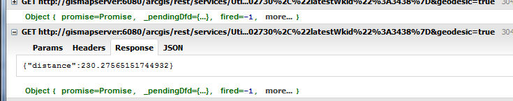

  The GeometryService.distance method returns a deferred
Name                                                      Return Type  Summary
distance(params, callback?, errback?)    Deferred        Measures the planar or geodesic distance between geometries.
So you function should look more like this:
