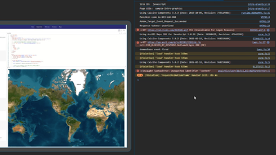

Hello,
after updating the raspberry pi chromium to version 146, the route calculated on the map is not visible any more.
I dont see an error in the browser log.
To be sure that the my app is not the cause of the issue, i also tried it on the example page https://developers.arcgis.com/javascript/latest/sample-code/directions-routelayer/
There is no route visible on chromium 145 (and chromium 146), too.
On chromium 142 it has been working without any issues.
WebGL is hardware accelerated according chrome://gpu list, WebGPU is disabled.
The maps are displayed without problems.
Do you have an idea?
Thanks!

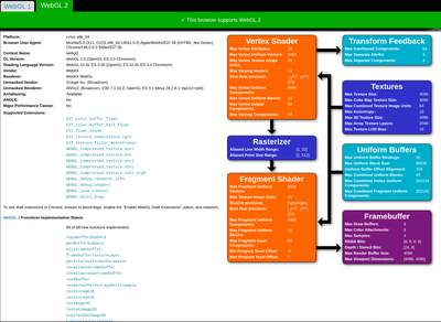

@Alamos if you go to https://webglreport.com/?v=2 does anything seem off? You might need to make a bug report on the chromium project (https://issues.chromium.org/) if this is a regression in the latest version of chrome.
Alamos
It seems that everything is set up right.

Alamos
Even though the map layer seems to load a little bit faster, the graphics on the page are still not visible, even with the Mesa 26 update. 😞
AndyGup
Based on the troubleshooting so far, this appears more likely to be related to a regression in Chrome on this specific hardware platform than to the SDK itself. We haven’t been able to reproduce it internally because we don't currently have access to your exact hardware, so we can’t fully validate the behavior on our side.
Since WebGL2 issues can be browser/GPU/platform-specific, it may be worthwhile to open a Chromium issue as a next step (https://issues.chromium.org/). If you do, feel free to share the link here and we’ll continue to help where we can.
