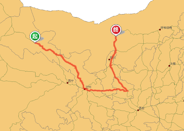

Hi, all:
     Now,Im studying a function about shortest route and I encounter a problem.
     I released by arcmap successful network analyze service.
     When I try to generate any route, the route is not show in the graphic layer.
     When the code is debug to see where is the error, it does't show any problem, and looks all ok.
     Can someone give me and advice on where the problem can be???
     Here is the js code:

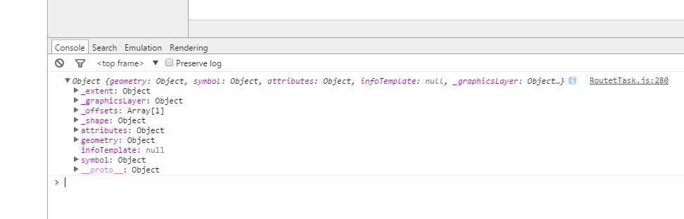

  function showRoute (result) {
  var routeResults = result.routeResults;
  routes.push(
  map.graphics.add(routeResults[0].route.setSymbol(routeSymbol))
  console.log(routeResults[0].route.setSymbol(routeSymbol));

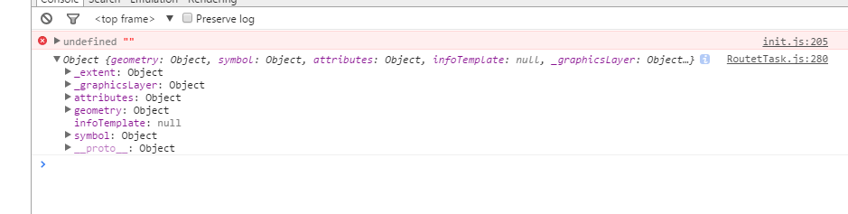

When I use another  routeTask url (that was published long time ago), route can be created.
daihere
Deactivated User
I don't know why use new url (that is new publish in arcmap) can't show the route in the map.
So, I need your help~
RobertScheitlin__GISP
MVP Emeritus
Dai,
   Was your ArcGIS Server upgraded and the new service is running on a different version of AGS then the old service was? What line does the undefined error point to?
