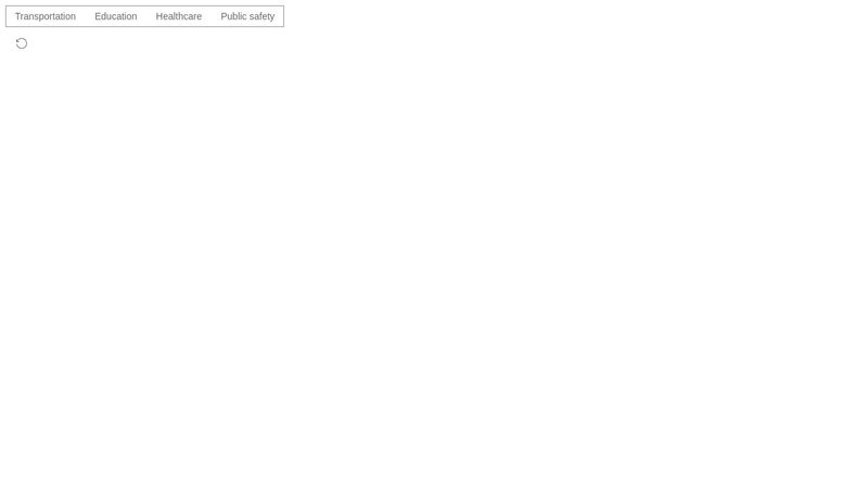

How are segmented control components reset? Setting the value = null or '' effectively clears the selection, but whatever value was previously set is not 'selectable' again until an alternate value is selected.
Here's a pen reproducing the issue - https://codepen.io/derekwmiller/pen/bNdxKEm
Select a value -> click the reset icon / button -> try to select the same value -> cannot select it

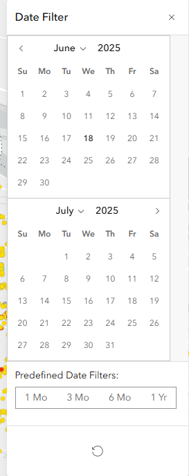

MillerDerek
Thanks for the info @KellyHutchins. That makes sense. Checkboxes are less than ideal in this scenario -- image below.
I put together a work-around with a disabled & hidden calcite-segmented-control-item. The value of the segmented control is set to the hidden item on reset.
