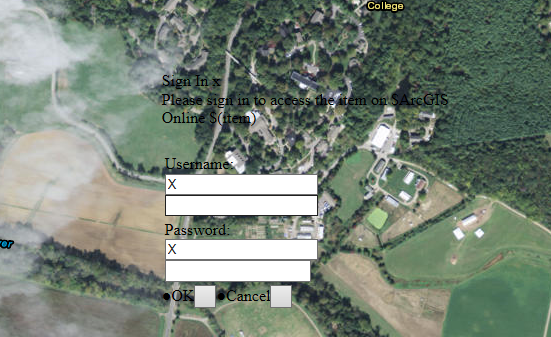

Using this sample (or any I have tried):  ArcGIS API for JavaScript Sandbox
When you use a secure service which causes a prompt, you get this.  I assume that there is some css tweaking that could get this looking decent, but is that the best solution?  Or is there a better way to handle this that I am missing?

Nicole,
   You just need to add a dojo theme like claro or tundra:

Robert,
Thank you!  That worked great.
