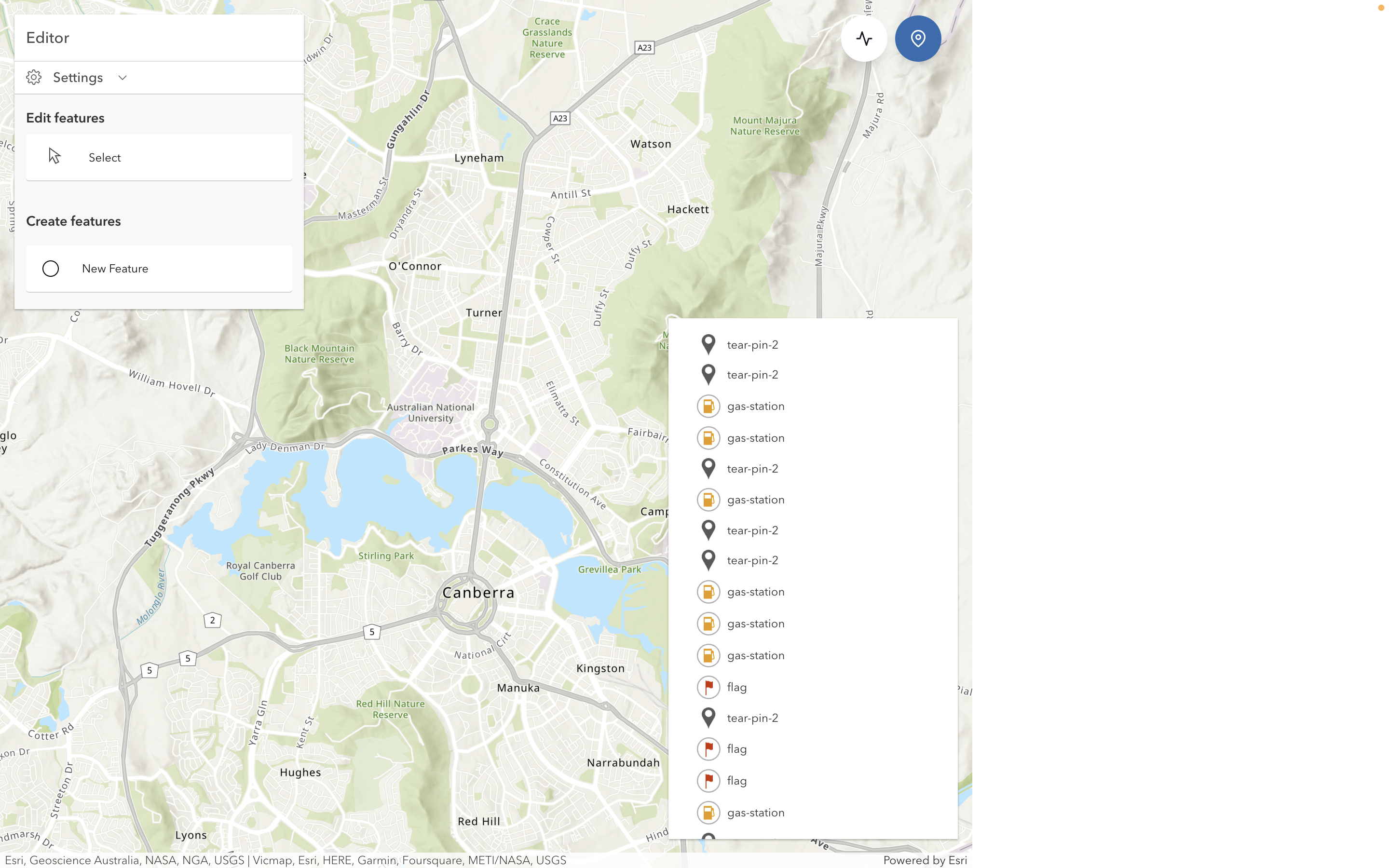

Hello,
We are using the editor widget in ESRI for the crud operations of the symbols. I was able to succesfully render a webstyle symbol using the simple renderer.
    const layer = new FeatureLayer({
      source: graphics,
      // renderer,
      renderer:{
        type: "simple",
        symbol: {
          type: "web-style",  // autocasts as new SimpleFillSymbol()
          styleName: "Esri2DPointSymbolsStyle",
      objectIdField: "ObjectID"
The use case which I currently have is to render more than one webstyle symbol in the editor. Since the simple renderer does not accept array of symbols , Is there any renderer which I can use to display the symbols on the editor.
I was trying it out with unique-renderer , but it does not seem to be working. Please find the screenshot attached
Thank you

The unique-value renderer should do what you want. If it didn't work for you, it's likely you have some sort of syntax error. Here is a code example.
const hwyRenderer = {
          type: "unique-value",
          legendOptions: {
            title: "Freeway type"
          field: "RTTYP",
          uniqueValueInfos: [{
            value: "S",
            label: "State highway",
            symbol: {
              type: "simple-line",
              color: "#e6d800",
              width: "6px",
              style: "solid"
            value: "I",
            label: "Interstate",
            symbol: {
              color: "#e60049",
              width: "6px",
              style: "solid"
            value: "U",
            label: "US Highway",
            symbol: {
              color: "#9b19f5",
              width: "6px",
              style: "solid"
https://developers.arcgis.com/javascript/latest/visualization/data-driven-styles/unique-types/#categ...
