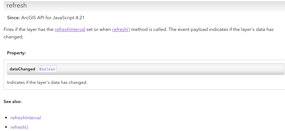

UndralBatsukh
Hi there,
If you go to the refresh event description, you will see that refresh event was added at 4.21. See the since tag in the screenshot.
https://developers.arcgis.com/javascript/latest/api-reference/esri-layers-FeatureLayer.html#event-re...
Hope this helps,
