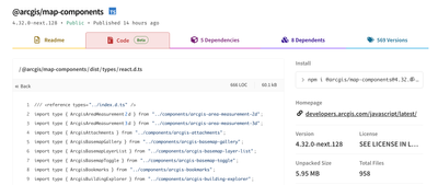

If anyone else sees this later and wants to start from scratch, I followed https://vite.dev/guide/#scaffolding-your-first-vite-project to create the sample.
Ref for 4.32-next.128 and the react.d.ts file https://www.npmjs.com/package/@arcgis/map-components/v/4.32.0-next.128?activeTab=code
