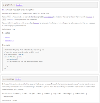

Aeseir
I can't seem to find your reference to ready, all it does it takes me to resizeAlign.
Regardless seem like we need to build a global event to track this.
BlakeTerhune
MVP Alum
MapView ready is right above resizeAlign in the documentation Rene linked to.
Aeseir
we are seeing 2 different versions of documentation then because i can't see it and here is the image to prove.

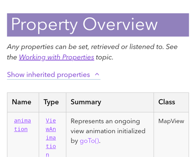

Click on "Show inherited properties"
Aeseir
Thanks for the tip @ReneRubalcava, missed that obviously.
