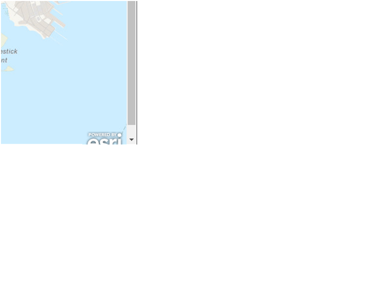

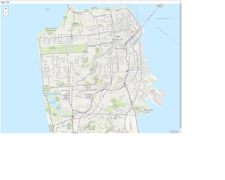

I try to do a simple test, just add a map and its title to a html file. But at the right-bottom corner, there is always space, and the vertical scroll bar always exists. I want the map and title display as a whole thing without any vertical scroll bar. See my codes below and the Pics. I have set the div container as 100%, but why the vertical scroll bar is not gone? Thanks!

Lei,
  Here is another way if you do not want the title on the map:

Try:

Lei,
