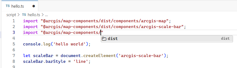

I have the same issue, but only when using TypeScript. Find a basic repro attached. Unzip it, run `npm install`, and open the folder in VS Code. A JS file in the same project does not have the issue.
Per this screenshot, note that autocomplete only offers "dist" after "map-components".
If you don't include "dist" in the path, you'll get an error squiggle under the "barStyle" property of the arcgis-scale-bar element.

The moduleResolution setting in tsconfig makes a difference. I see in the repo Sage_Wall linked, it specifies "bundler" for this property, whereas I'm using "node". (Per the guide on Webpack's site - https://webpack.js.org/guides/typescript/).
Reading into it, module resolution "node" is an older version, which seems to not support package.json "exports". Recommendations online point to "node16" or "nodenext" - for my example, these got part-way there, the import was fine, but VS Code was still putting a squiggly line under the reference to HTMLArcgisScaleBarElement property "barStyle". (Though it doesn't produce a build error). Moduleresolution "bundler" seems to satisfy all cases: it doesn't require "dist" in the import, VS Code is happy with the reference to custom element property, and build doesn't produce any errors.
In my legacy project, I'm a little hesitant to switch moduleResolution just for the sake of getting rid of "dist" in the import statements. I haven't experienced any other issues using the "node" resolution strategy. I wonder if the guide on the Webpack site might be a bit out of date though.
