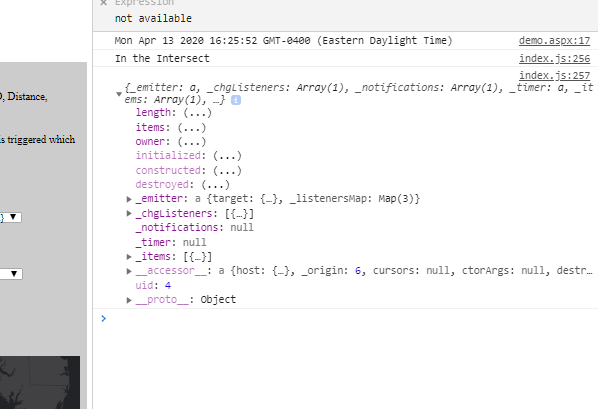

Dosent give me anything...Add alert in there "In the Intersect" to make sure it was in the function
Nothing in the Console Error wise...
queryCountiesthatIntersect().then(displayResults2).else(function (err) {
console.log(err);
function queryCountiesthatIntersect() {
         console.log("In the Intersect");
          console.log(resultsLayer2.graphics);

jaykapalczynski
Honored Contributor
I got it with this: i was missing the "items"
query.geometry = resultsLayer2.graphics.items[0].geometry;
NOT
query.geometry = resultsLayer2.graphics[0].geometry;
I had to walk the console.log of the Graphics layer a bit more
