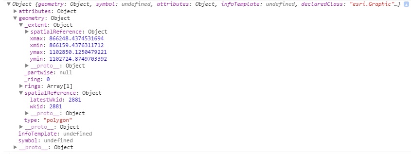

Ive done this many times, but for some reason this is not working for me and I have no clue why.
The execute statement looks like
qt.execute(query, function(results) {
       console.log(results.features[0]);
     //symbol not used(will be used once polygon is figured out
    var redSymbol1 = new SimpleFillSymbol(
       SimpleFillSymbol.STYLE_SOLID,
      new SimpleLineSymbol(SimpleLineSymbol.STYLE_SOLID, new Color([255, 0, 0]), 3),
      new Color([255, 0, 0, 0.4])
     var graphic1 = new Graphic(results.features[0].geometry, redSymbol1);
     //Add graphic to the map graphics layer.
      map.graphics.add(graphic1);

It looks like the issue is related to the coordinate system of the Parcels layer.  It's currently using WKID 2881.  The query results are returning the results in this coordinate system, but the map's spatial reference is in Web Mercator.
You will just need to set the outSpatialReference property for the Query class to the map's spatial reference.  Ex:
query.where = "PARCELID ='" + graphic.attributes["PARCELID"] + "'";
query.returnGeometry = true;
outFields = ["*"];
query.outSpatialReference = map.spatialReference;
query.outFields = outFields;
outFields = ["*"];
IbrahimHussein
Deactivated User
Thanks, that worked.
