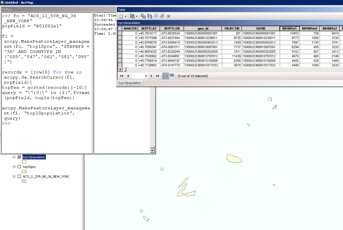

If you just need to get some data, you could load the file gdb from the Census into ArcMap. Since you can't do "top n"/subqueries in a file gdb (you can in a personal gdb), I created a script that should get what you need:
fc = "ACS_11_5YR_BG_36_NEW_YORK"
popField = "B01001e1"
fl = arcpy.MakeFeatureLayer_management(fc, "top10pre", "STATEFP = '36' AND COUNTYFP IN ('005','047','061','081','085')")
records = [row[0] for row in arcpy.da.SearchCursor(fl, popField)]
topTen = sorted(records)[-10:]
query = "\"{0}\" in {1}".format(popField, tuple(topTen))
arcpy.MakeFeatureLayer_management(fl, "top10population", query)
This will output two layers - the last one will have what you need "top10population":
This will give you the top ten block groups, considering only those block groups that are within NYC (the five NYC boroughs - see the COUNTYFP for the fips values).
