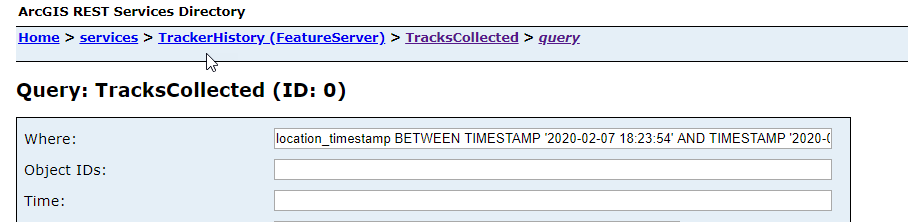

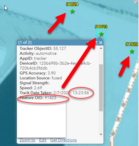

Here's what's in the webmap viewer.  The OID's labelled are reflecting what I want to query, where the middle point of the 3 point features is the desired result so my query should return feature oid 91823:
Here's the REST query task.  The full query is converted to GMT from my localtime (look at the popup of the middle point is 2020-02-07 13:23:56 so I should return 1 feature with this query "location_timestamp BETWEEN TIMESTAMP '2020-02-07 18:23:55' AND TIMESTAMP '2020-02-07 18:23:58'"):

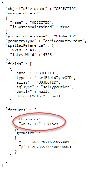

Here's the REST query result: 1 feature and the OID matches!
