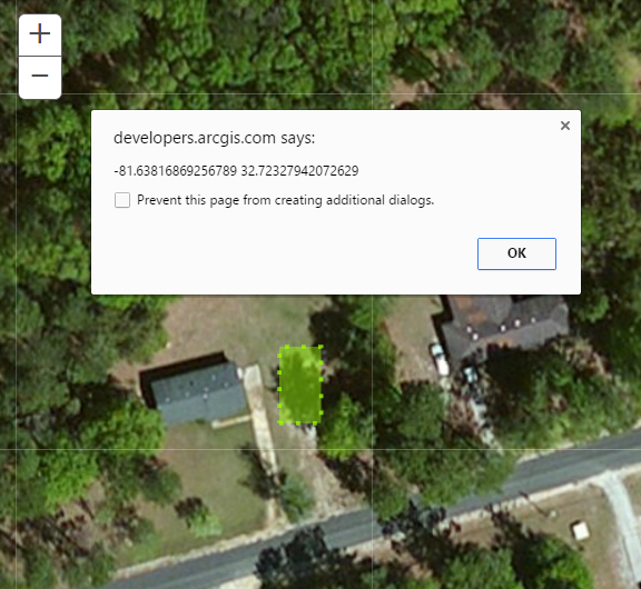

Hi Dave,
I am using the following code to construct the geometry
var polygon = new Polygon({
            "rings": [
                [-81.63820933449949,32.72321758156744],
                [-81.6381280506363,32.72321758156744],
                [-81.6381280506363,32.723341259885146],
                [-81.63820933449949,32.723341259885146],
            "spatialReference": {
              "wkid": 4326
for this geometry the Cendroid is the following
alert(selected.geometry.getCentroid().x + " " + selected.geometry.getCentroid().y);
as you can see the cendroid point has the right coordinates.
check how the polygon constructed.
