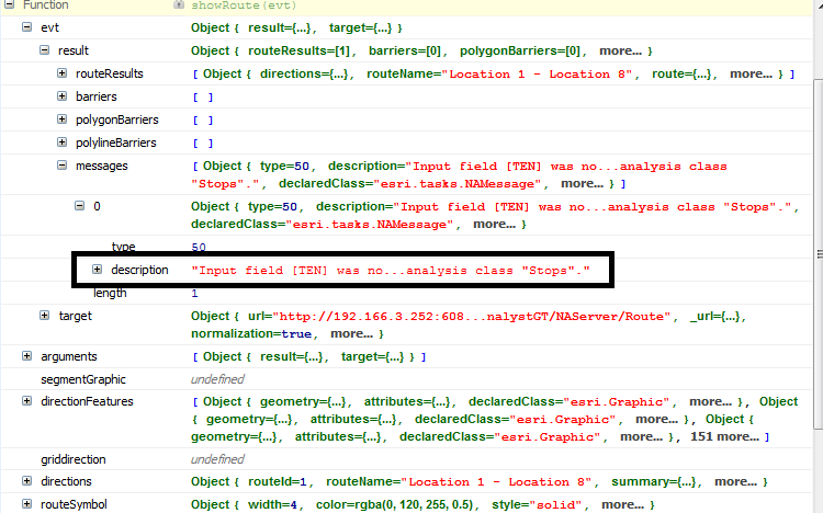

not get information points of router,   returns Locattion 1, loacation2 ....
i use firebug get messages atribute of routeResults
"Input field [field] was not mapped to a field in the network analysis class "Stops"."
below image firebug

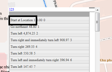

information direction:

Did your query return a result?  If no results are returned, then no stops will be created.  Or there may be too many stops for a route to be solved.
Are the stops using the same spatial reference as the route network used?  If they are not, the stops won't be close enough to the route's street network to be considered a stop point.
Regards,
Tom

My query return a few points
yes, i use router netwword, i was showed points and router, i not show points address in results direction
i displayed direction of the router,  but instead of displaying the specific points address, Then  the results returned is the location1, locattion2 in the directions

To get the stop name to appear you must assign it as you add the stop.  It would be ideal if when you added a stop that it would find a "Name" field and use it for your stop location name.  To solve this problem, I created an stop object to use for each feature and explicitly added a stop name.
  // add the selected stops
  arrayUtil.forEach(selectedGraphicsLayer.graphics, function(feature, i) {
       var a = feature.attributes;
       // make a stop so we have name and XY
       var stop = {
            feature: {
                 geometry: {
                      x: feature.geometry.x,
                      y: feature.geometry.y
                 attributes: a
  directions.addStop(stop);
  directions.getDirections();
This example was from a craft beverage tour where the app user can select which locations they would like to visit and create driving directions.  You can view this example at:  Craft Beverage Tour  Please view source to see how I manage the stops for this app.
I hope this helps!
