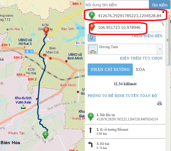

problem Directions use geocoding service (arcgis server 10.2)
2993
10-09-2015 05:00 AM
lasinh
i use The Directions widget   to calculate directions between two  input locations,  and adds a stop on each map click ( mapClickActive: true), but when i click on map then result in input is lat, long(coordinates);  how to get address to input parameter Directions widget when map click?
have services geocoding(on arcgis 10.2 server) allow get address when click on map ??
i use geocoding services on arcgis 10.2 server.
