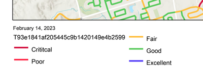

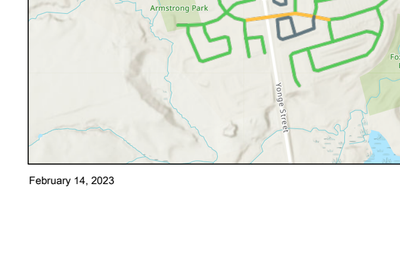

I have a weird issue where my PrintTask outputs are missing legend, sometimes, but not others, and I can't find a pattern as to why.  I have a unique value render setting with ~160 different values in it, and on most of the maps I use a valueExpression to set the renderer.
If I take two maps which use the same valueExpression, literally the same one, and compare them, one will generate with legends, and the other won't.
Map 1:
Map 2:
The valueExpression: When($feature.aType == 3 && $feature.ci > -10 && $feature.ci <= 40, 'condition_3_Crititcal',$feature.aType == 3 && $feature.ci > 40 && $feature.ci <= 50, 'condition_3_Poor',$feature.aType == 3 && $feature.ci > 50 && $feature.ci <= 65, 'condition_3_Fair',$feature.aType == 3 && $feature.ci > 65 && $feature.ci <= 90, 'condition_3_Good',$feature.aType == 3 && $feature.ci > 90 && $feature.ci <= 99, 'condition_3_Excellent',$feature.aType == 3 && $feature.ci > 99 && $feature.ci <= 100, 'condition_3_Perfect',$feature.aType == 3 && $feature.ci > -10 && $feature.ci <= 0, 'condition_3_Not Defined','condition_Not Defined')
That is the valueExpression shared by both maps, the first will generate a legend, the second won't.  This is my print function:

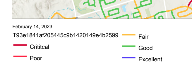

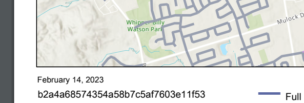

On a strange note, I don't use a valueExpression, I always get a legend on the print output:
I suspect the problem has to do with the use of the valueExpression, so is there a way to pass my legend / layer information directly to the print task?

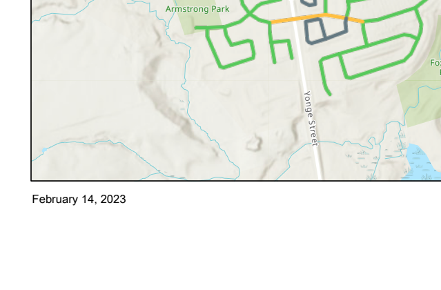

Thanks for the suggestion, I'm kind of baffled as to why I didn't think of that myself.  The “featureCollection” object is missing when the legend isn't present.  When I don't have the “featureCollection”, I have “imageData”, and I think that's what is causing the problem.
Should I be adding in LegendLayers into the Print Parameters?  https://developers.arcgis.com/javascript/latest/api-reference/esri-rest-support-LegendLayer.html
