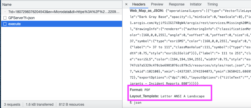

If you open the developer tools of your browser and look at the network traffic, you can see the Format and Layout_Template in the request:
