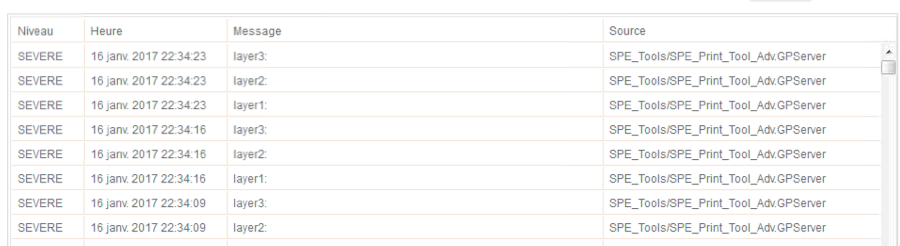

I've tried to implement a print widget using the print task very closely following this tutorial. However, it is very slow (~60 seconds to export an A3 pdf with default dpi) and I notice the following severe ArcGIS for Server logs:
Has anyone seen this type of vague log?

Are you trying to print complex data (vector data with many vertices or imagery)?  If so, you might want to try testing on a simpler data set and see how long it takes to print that out in comparison?

It does seem to take less time when removing layers--understandable. However, the end user will need to print about as much as I'm testing, plus, I hadn't noticed this slowness when using the out of the box print widget on the same amount of layers. I think there's something wrong with the gp script, but I'm not sure where to start looking considering the vague error message.

Maybe it has something to do with the setup of your proxy.  In my application that was started from an ESRI sample the proxy was:
esriConfig.defaults.io.proxyUrl = /proxy (Shorthand for ESRI's proxy)
which I changed to:
http://"MyServerName"/Proxy/proxy.ashx
Your sample has a proxy:
"http://ourwebserver/Java/proxy.jsp";
Did you use that same proxy when the application was using the out of the box print widget?
