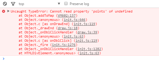

but I am getting this error
can you please let me know how I can get a list of lat and long of multi point?

case "multipoint":
 symbol = new SimpleMarkerSymbol();
console.log(this.points);
break;
 but the console.log() is not printing out any thing however I am not getting error neither

Bengi,
  Your likely issue is that you did not change the switch block to handle the point and multipoint separately:

BehrouzHosseini
Thanks Robert, this is working perfectly. Just one more question?  Can we use the same mechanism to get vertices of Polygons and Line or Polylines , as well?
