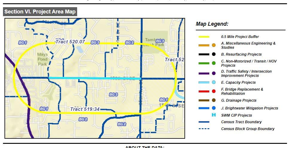

As I keep working on migrating my 3.X app to 4.X, I keep hitting issues. Now, it's print output. The same basic code block, adjusted for 4.X differences, produces a vastly different output. The final part of a custom report generating tool is to produce a JPEG map and insert it into a HTML report output. The output from 3.X produces this:

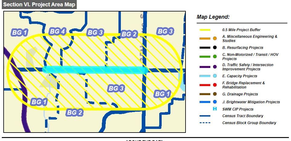

The 4.X API output results in this:
It's almost as if there's a "reference scale" setting that I haven't adjusted but, from looking over the API reference, I can't see any. Is there one? There really isn't much to the code side of things so I'm kinda flummoxed but this.

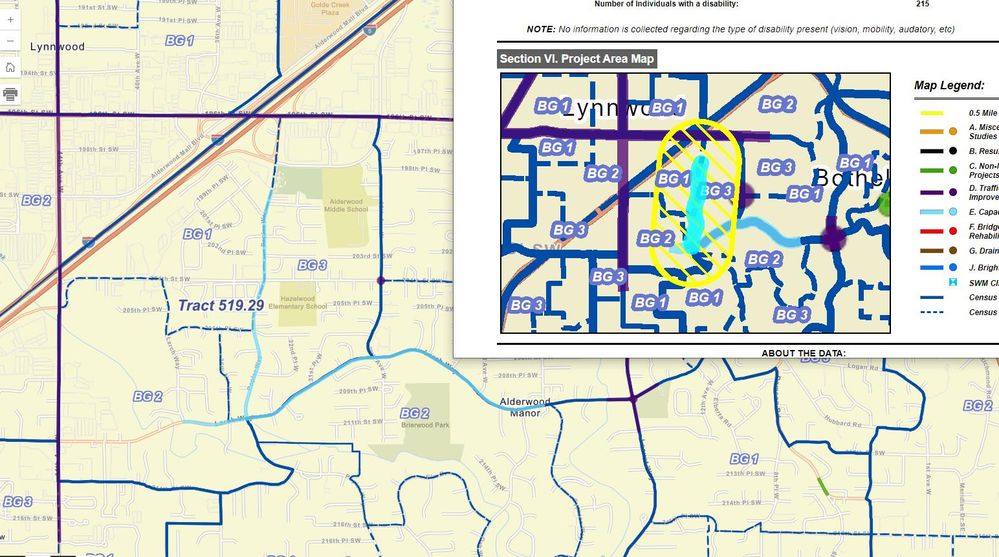

Hey Joel, I have been playing with that setting but I don't think that's the way to go. The physical dimensions of the JPEG map export are different than the mapView's extent on screen so if you try to use scalePreserved (in concert with outScale), the resulting JPEG map won't accurately show the feature with the buffer I apply to it. Example-
I was getting inconsistent print map extents, which was super frustrating. I finally re-read the API docs and the goTo() method returns a promise so I think my code was behaving more async than sync. I added a when() after using goTo and wrapped the map export process inside that function at the map extents are behaving more like I would expect.
The thing I really want to resolve is the symbology and labels which get blown up out of proportion. Again, the print output is similar to what you experience inside desktop if you alter the Reference Scale property of the Data Frame. It's just that the layer & label symbology is not correctly scaling with map scale.

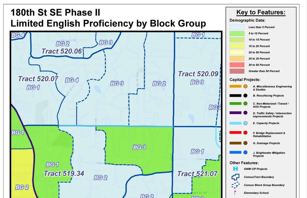

The issues I've been describing are using the print.execute() option for printing rather than using the Print widget. I do use the Print widget in a different part of my app and that output is what I would expect-

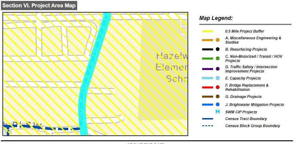

Ugh. You know, changing the DPI parameter was a conscious decision when I migrated the code but the manner in which it's implemented was unexpected. Changing it back to 50 yielded the same print results so thanks for pointing to that.
My intent with bumping up the DPI was to increase the sharpness of the output image, much like when you bump up the DPI when exporting to a PDF. In reality, the export map function seems to have ended up just zooming into the map since the dpi I specified was doubled. Anyways, thanks again. Glad that my remaining migration issue is now solved.
