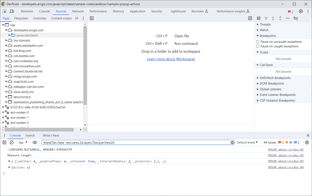

In the code above, changes to the original are found on lines 6-8, 19-20, and (primarily) 77-84.  After the sample is refreshed, clicking on a feature and then the "Measure Length" action in the popup produces the following in the console, showing the expected output:

I've found it to be working properly.  In the sandbox for the "Popup actions" sample, you can change the code in the script tag beginning on line 27 to the following:
      require([
        "esri/Map",
        "esri/layers/FeatureLayer",
        "esri/views/MapView",
        "esri/geometry/geometryEngine",
        "esri/core/reactiveUtils",
        "esri/widgets/Popup"
      ], (Map, FeatureLayer, MapView, geometryEngine, reactiveUtils, Popup) => {
        // Create the Map
        const map = new Map({
          basemap: "gray-vector"
        // Create the MapView
        const view = new MapView({
          container: "viewDiv",
          map: map,
          center: [-117.08, 34.1],
          zoom: 11,
          popup: new Popup({})
         * The PopupTemplate content is the text that appears inside the
         * popup. Bracketed {fieldName} can be used to reference the value
         * of an attribute of the selected feature. HTML elements can be
         * used to provide structure and styles within the content.
        // Add this action to the popup so it is always available in this view
        const measureThisAction = {
          title: "Measure Length",
          image:
            "https://developers.arcgis.com/javascript/latest/sample-code/popup-actions/live/Measure_Distance16.png"
        const template = {
          // autocasts as new PopupTemplate()
          title: "Trail run",
          content: "{name}",
          actions: [measureThisAction]
        const featureLayer = new FeatureLayer({
          url: "https://services.arcgis.com/V6ZHFr6zdgNZuVG0/arcgis/rest/services/TrailRuns/FeatureServer/0",
          popupTemplate: template
        map.add(featureLayer);
        // Execute each time the "Measure Length" is clicked
        function measureThis() {
          const geom = view.popup.selectedFeature.geometry;
          const initDistance = geometryEngine.geodesicLength(geom, "miles");
          const distance = parseFloat(
            Math.round(initDistance * 100) / 100
          ).toFixed(2);
          view.popup.content =
            view.popup.selectedFeature.attributes.name +
            "<div style='background-color:DarkGray;color:white'>" +
            distance +
            " miles.</div>";
        // Event handler that fires each time an action is clicked.
        reactiveUtils.on(
          () => view.popup,
          "trigger-action",
          (event) => {
            // Execute the measureThis() function if the measure-this action is clicked
            if (event.action.id === "measure-this") {
              measureThis();
        view.popup.on("trigger-action", function(target, event) {
          const featureLocation = target.location;
          console.info(featureLocation.x + ", " + featureLocation.y);
          console.info(event.action.title);
          console.info(target);
          console.info(event);
        }.bind(this, view.popup));
If I had to guess as to why it isn't working for you, perhaps the call to bind was not made correctly.
