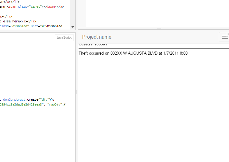

Does anyone have any ideas on how to use the popupMobile and a bootstrap navbar-fixed-top together?  No matter what I try css-wise for z indexing and/or padding I cannot get the popupMobile's navigation bar to display on top of the bootstrap navbar.  Do I need to get into the helper methods for placement maybe?
Thanks
David

Not sure if I'm visualizing this correctly - is the problem exemplified in this jsfiddle I created?
Bootstrap nav bar; mobile popup ArcGIS - JSFiddle

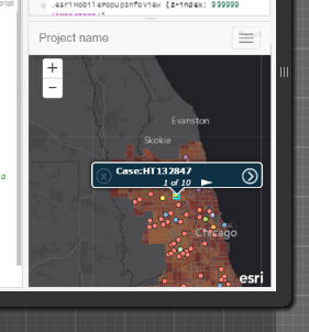

If so, I was able to place it above the nav bar by adding a css override; here's the jsfiddle update:
And the overrides:
.esriMobileInfoView {z-index: 999999 !important;}
.esriMobilePopupInfoView {z-index: 999999 !important;}
.esriMobileNavigationBar {z-index: 999999 !important;}
Hope I understood your issue correctly!

That's exactly it Chris, thanks!  It was driving me nuts. My z-index was too low (108 - based on WAB) and I was missing the .esriMobilePopupInfoView class.  I now have:
.esriMobileInfoView , .esriMobilePopupInfoView, .esriMobileNavigationBar {
