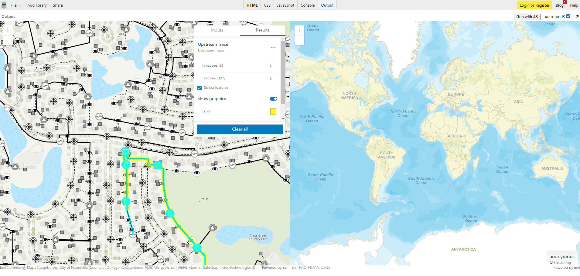

2. In the left mapview, a utilityNetworkTrace widget has been added to perform a utility Network Trace analysis.

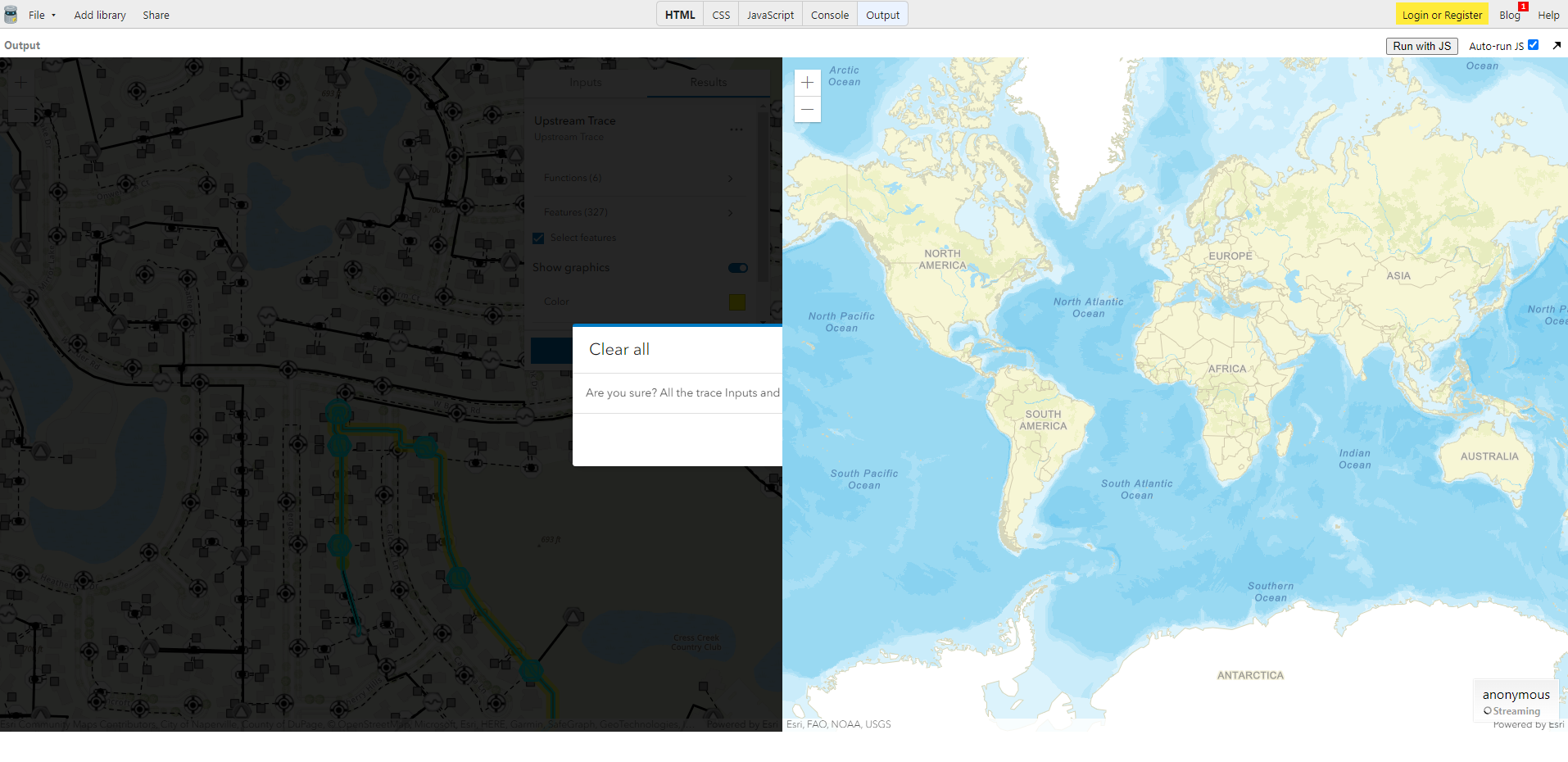

when the trace analysis is complete and I want to clear all the selected features, a popup window appears for me to confirm. This popup window is displayed in the middle of the page, not in the middle of the mapview, which causes the popup window to be blocked by other dom elements.
See screenshots:
pitcure1: after the execution of the trace analysis
pitcure2: after clicking the "clear all" button
I think this should be a bug, as expected the popup window should be displayed in the middle of the mapview container it is in, not in the middle of the page.

Thanks for reporting this issue, we are using a modal in the widget, and this is causing the underlying issue. We logged an issue internally, and will be replacing this modal with another component within the widget to provide the same message, but prevent this issue from occurring.

@Lerman Making changes to the code won't really be an option right now since it's minified and the modal is a calcite component part of the rendered UI.
A temporary workaround would be to make changes to your app UI such as switching your maps so that the right side of the modal is displayed and the buttons can still be clicked.
