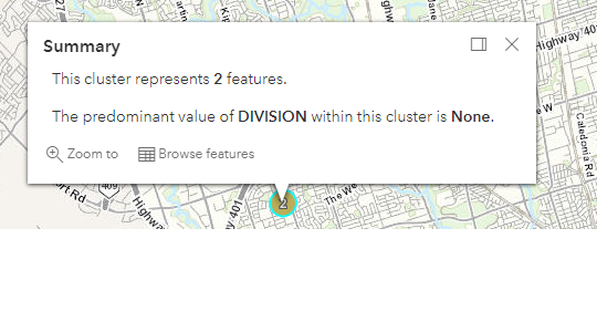

Hi,

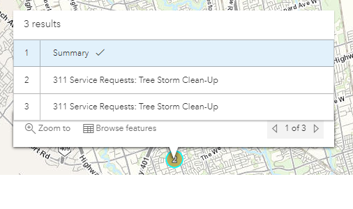

I have a popup for cluster point data.  When I open the popup for a cluster location it provides the summary page in popup along with the rest of the features.  If I scroll to a feature and click a custom action button that I wrote, after the action is complete it will go back to the summary page- selectedFeatureIndex = 0.  I have tried setting the index to the selected featue in the action, but it is not working.  Any ideas on how to prevent this behavior.

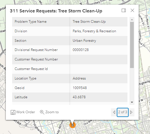

I am adding an action button to a layer pop up.  After getting to a selected feature through the pop up list the action button appears.  The action uses the selected feature attributes to query another layer and displays results in a handlebar div.  After calling that action the selectedFeatureIndex goes to 0 and the summary content is displayed.
I tried setting the pop selectedFeatureIndex to see if I can maintain the selected feature in the popup.
view.popup.viewModel.selectedFeatureIndex = 1;  //example.
Summary page after clicking on clusterSummary page after clicking on cluster
Select the featureSelect the feature
Click work orderClick work orderReturns to this popupReturns to this popup
