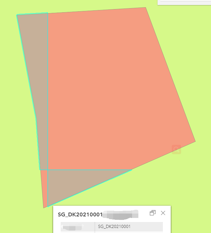

but, when I register the database to ArcGIS Server,  I  call the  popup.open()  function to show a feature's property,  some unfixed errors have occurred.   I noticed that the new unique field added by ArcGIS changed from OBJECTID to ESRI_OID,  I modified the codes, but, error still.  The error appeared is that when I popup a feature, the highlight geometry is part of the target feature or sometime is other feature. something like this:

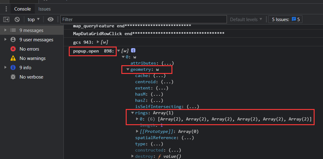

but now the geometry obtained from server is correct, there are 6 points for the geometry.

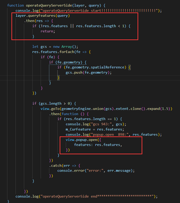

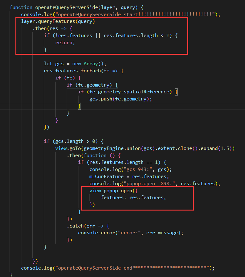

Here is my code.
Could you please tell me how to fix this bug  or  possible reasons? Looking forward to your reply, Thanks!
