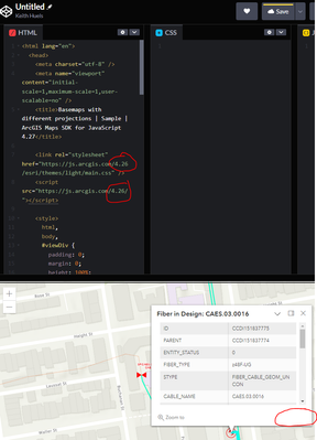

The data comes from an enterprise portal, so I couldn't share it, but I reproduced it locally and the error occurs when switching to 4.26 or higher.
We confirmed it is because the value is NULL. Below are screenshots, but if you would like to meet to see it live, let me know. Thanks
