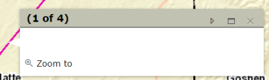

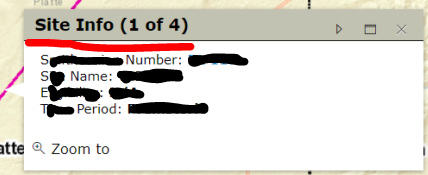

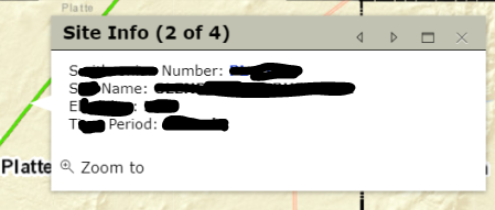

Using JS 3.2x, I have an issue with the content from the first feature not displaying when the popup first appears. I can cycle to the next feature and then go back and it appears. I've tried the examples using the deferred method and this method of pushing the feature to an array and setting the array, both with similar results. I extracted the code that deals with the popup. I need the ability to either return one result or multiple results so the code goes down which ever path it needs to in order to return content. I could probably test the array for length and process there, but doing that it doesn't give me the option to go forward and back to see that content. Any ideas/ tips/ suggestions?
