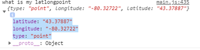

This is what i am getting in my console.

Not sure, but in the screenshot the lat/lon values display as strings, so maybe try converting them to numbers?
example: Number(result.lng)
