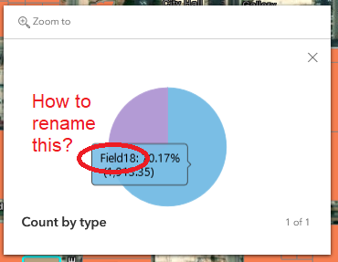

I created a pie chart in a popup using two field values (Field 18 and Field25).  When I hover on the pie chart it shows those field names which are meaningless.  I want to replace those field names with an alias or description of the field.  How can I do this?  My code is below.  Thanks.

Hi @JohnMax -
If you'd like to have a different label for the fields in your chart, you'll have to set the FieldInfos with the fields specified from the chart on the popupTemplate level: https://developers.arcgis.com/javascript/latest/api-reference/esri-PopupTemplate.html#fieldInfos
I updated your code to add the fieldInfos with labels so that the chart displays something different: https://codepen.io/laurenb14/pen/zYyzRqR?editors=1000
Hope this helps!
