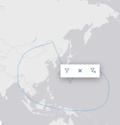

Using the sketchviewmodel i have drawn a graphic which acts like a polygon filter on the map.
Anyways, i have added logic such that clicking inside the polygon pops up a custom toolbar etc.

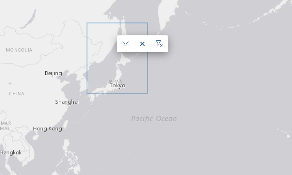

This works fine except in the case where i pan around the world. so in my screenshot above if i pan around the world and arrive at this polygon filter over japan again, if i click inside it, the mapPoint is never inside the polygonFilter.geometry  (ie. the contains() predicate always fails.)
I suspect it has to do with the mapPoint's x coordinate being outside the current extent xmin and xmax. do i need to be normalizing the mapPoint or the polygonFilter.geometry or both? and if so, how do i normalize it? Any help would be appreciated thanks!

If your polygon is always a rectangle, then the issue is straightforward:
var extents = polygonFilter.geometry.extent.clone().normalize();
var nPoint = point.clone().normalize();
