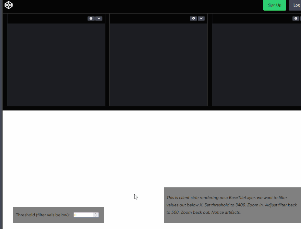

I have been working on setting up client-side rendering for Raster-based layers. I've created a customized BaseTileLayer where I can change the filter of the data client-side. However sometimes old tiles of data persist.
Example:
This codepen is a rough example that demonstrates the issue.
Set threshold to something like 3400. Zoom in a bit. Set threshold to 400. Zoom out. See old filter applied still for certain tiles.

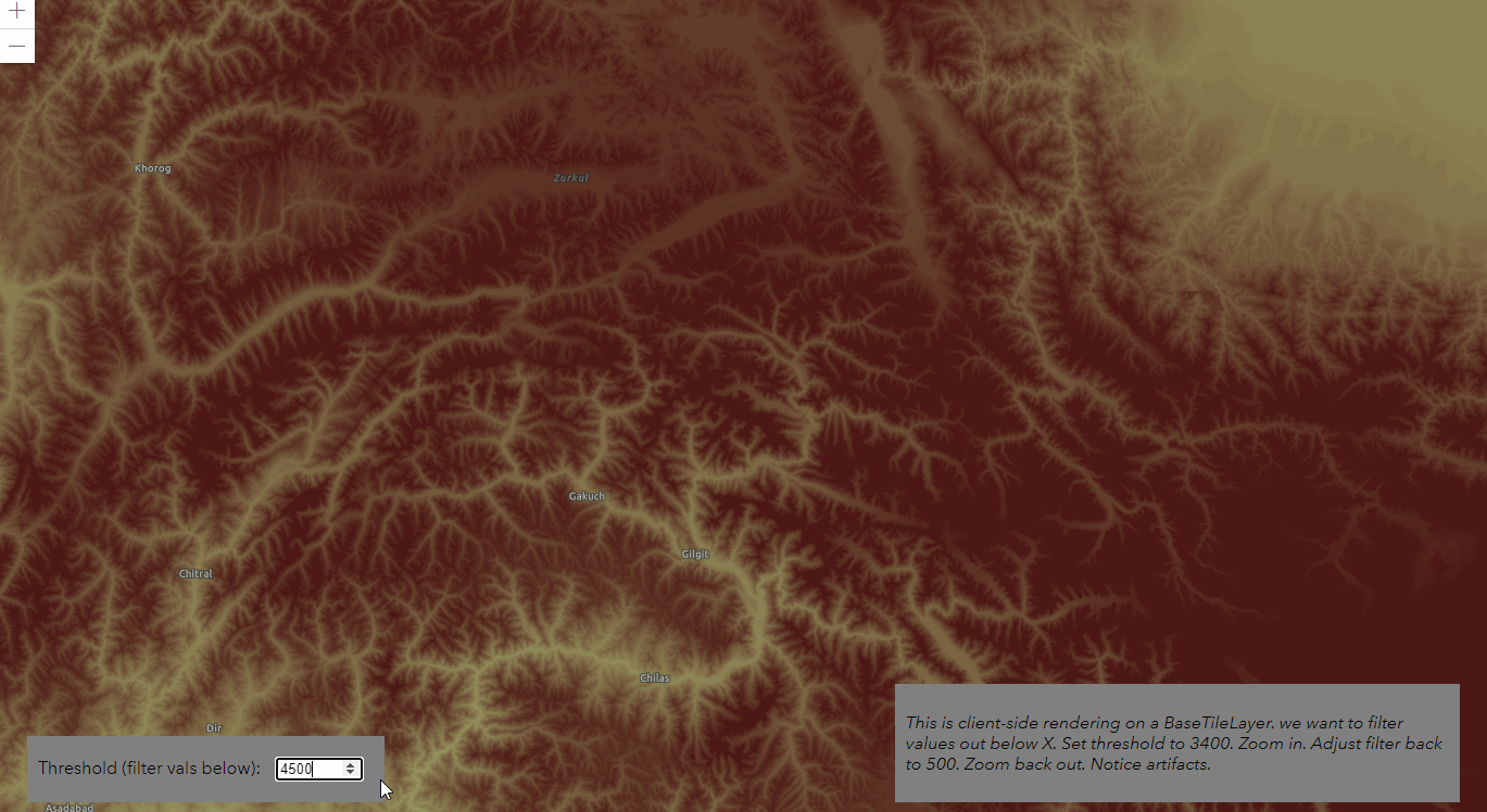

I just tested your code pen but I am still able to reproduce the problem I demonstrated above. Or at least there seems to be tiles not drawing correctly. Here is a video:thresholdCacheIssue.gif

The video was from Firefox. Note that it is import to return to your initial zoom extent. You want to zoom in, say 4x, then zoom back out 4x to return to the initial zoom level. I probably should have added a zoom element displayed in the codepen to show that.
I wasn't able to reproduce the problem every time. If I changed the threshold and waited for a few seconds too long before zooming I did not seem to get the issue. Also note there it looks like there are tiles that aren't drawing at all now whereas my initial example where we'd see the old filtered tile data remain?
At the office here I was eventually able to reproduce the issue (ff) though it too a few tries.
In Chrome the only way I was able to reproduce in the office now, is if I throttle the network speed. Then the problem is really easy to reproduce in your example (missing tiles, not old cached tiles). Try setting the network to 'Fast3G' to see what I mean.
