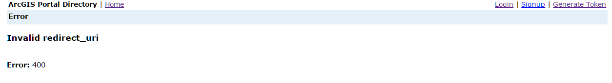

I'm trying to implement OAuth login for my web app. I followed the API sample here : Access ArcGIS Online items using OAuthentication | ArcGIS API for JavaScript 4.4 . It works for me when I open the live demo, but when I download the file and open it in chrome locally. I got this error:
How should I fix this?

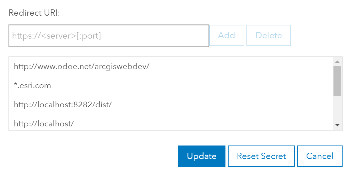

Go to your Online page, something <user>.arcgis.com, go to Content, filter by Apps/Registered Apps
Click on your app, go to settings.
Under settings, go to Application Settings area and click on Registered Info button.
Update the URI redirects here, this is what one of mine looks like.

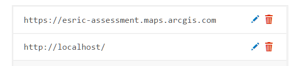

Thanks for the instruction. Similarly, I added my portals in the app
esriId.getCredential(info.portalUrl+"/sharing");
The getCredential function now works and showing the  AGOL login form
