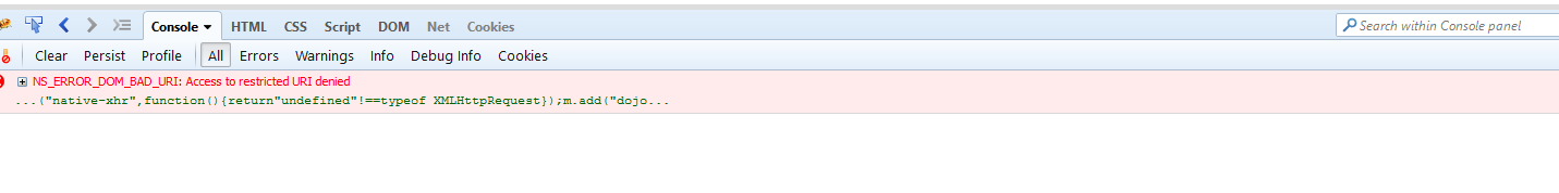

But no I just get a error:
Any Idea what this mean?
