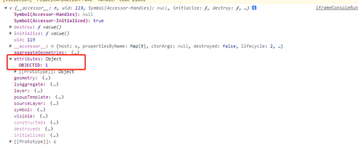

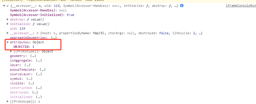

and then I Listen the click event,log the attributes,but it only has OBJECTID
view.on('click', (event) => {
        view.hitTest(event).then((response) => {
          console.log(response.results[0].graphic).attributes

FeatureLayer's outFields property has a wrong casing in your code. Please change it from
outfields: ["id"],
 to
outFields: ["id"],
Then it should work as expected.
