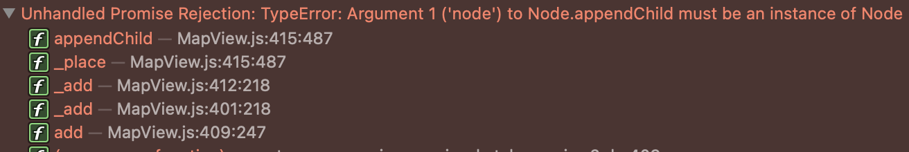

Hi,
I'm trying to add Sketch widget to my map as well as add some polygons based on info previously submitted.
When adding the widget an error is shown in the console and widget is not visible. Used a lot of time to figure it out without any luck. Hopefully someone can help me.
Here is the error message:
And here is my complete code:

If I comment out line 34, the polygon is drawn correctly, but obviously no widget shown.

LittleTurtle
Hello, maybe try adding your polygonGraphic before creating your Sketch
RamaniGanason
Can post your source where the viewDiv is created. The problem dont seems like to be with your Sketch.
