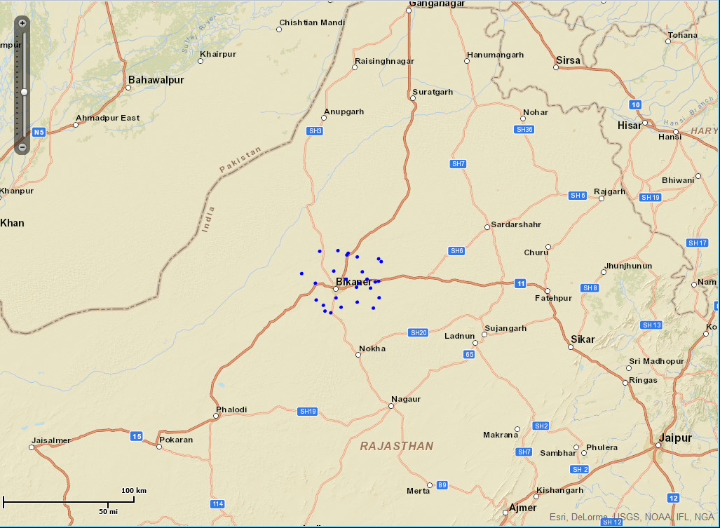

I did as you mentioned. But, i am not able to pass the mapPoint to the infosymbol and without it i am getting the result as attached.

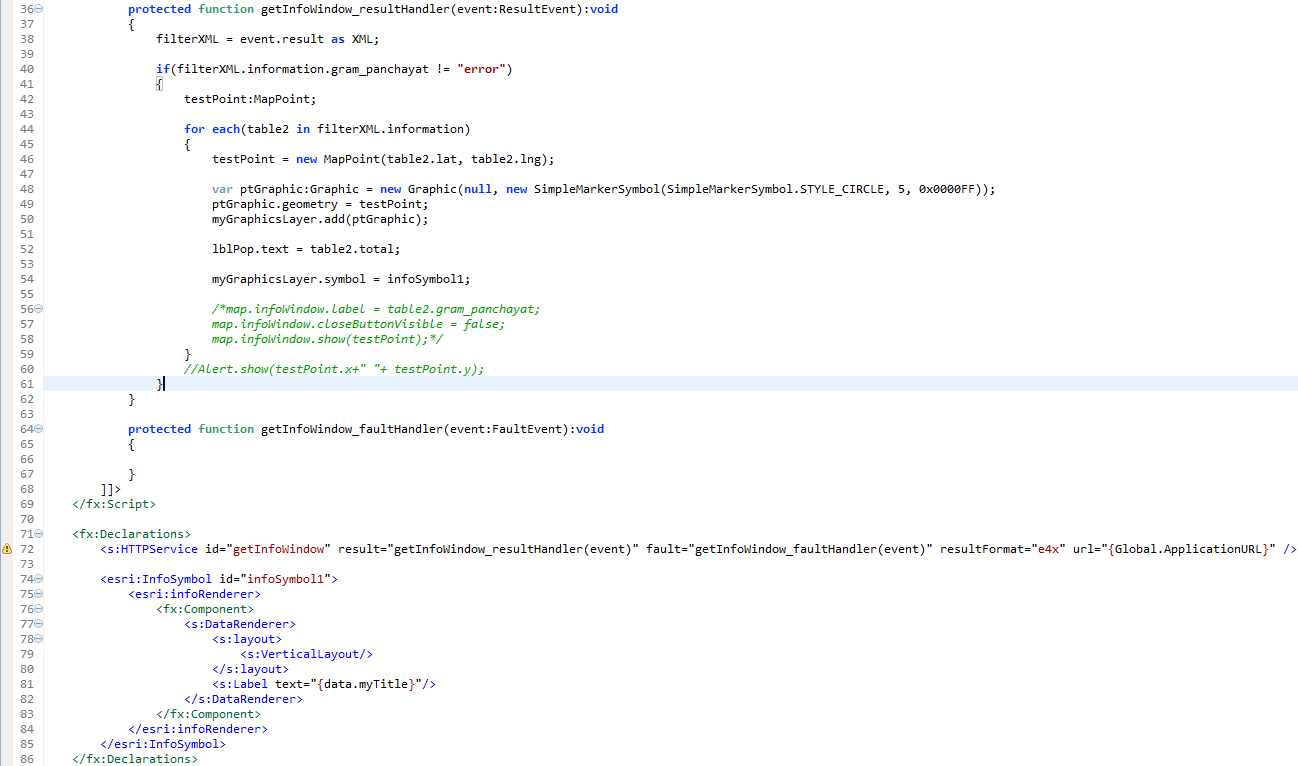

Also, i am attaching the code what i have done
