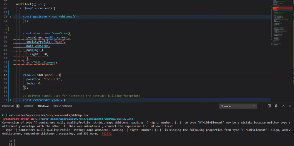

How to use import esri = ___esri in react + Typescript with ArcGIS JS API 4.18
Having below issue with View container able to fix it by adding as any. Looking for any better way?

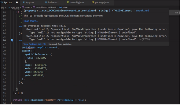

The ref.current from useRef can be Element or undefined. Try to do something like this.
if (mapRef.current) {
  // mapRef.current typing should now be inferred as HTMLDivElement
If all else fails you can say "as HTMLDivElement"

DivyaBathina1
Hi Rene,
Thanks for looking into this issue. Yes we have followed the same sample link which was useful.
Tried to do like below but still have issue and ui code is <div className="mapDiv" ref={mapDiv}></div>

ReneRubalcava
Esri Frequent Contributor
mapDiv.current as HTMLDivElement
divyabathina
its working now!!Thank you
